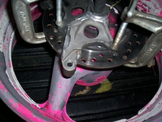

since i cant find any for an f4i .... i hacked one up
now i just have to get it welded

I don't think the C-clamps will have as good of braking power as calipers
Old Oct 28, 2006 | 11:57 PM
celgsxr's Avatar
Posts: 2,837
From: Motor City Freestyle in Detroit Michigan (0-o)
celgsxr has much to be proud ofcelgsxr has much to be proud ofcelgsxr has much to be proud ofcelgsxr has much to be proud ofcelgsxr has much to be proud ofcelgsxr has much to be proud ofcelgsxr has much to be proud ofcelgsxr has much to be proud of
Re: my method for dual calipers
damn it ......your right............ maybe ill get it welded and take them off then... now my master plan is all messed up

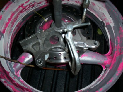

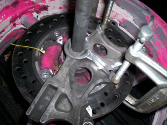

update dual calipers done wit some titnaum on my round bar.what

i didn't say go buy it, just make a real one. useing a front caliper. and being one solid piece. to many storries of welded ones breaking. freeway highchair coaster scrapes at 70mph to broke brake linkage is not a walk in the park recovery
Old Nov 10, 2006 | 01:00 PM
NINER's Avatar
Retired
Posts: 37,967
From: .
Oh word. Unless you have a gangster *** weld on those they break in two quicker than a Hollywood marriage.

There was a kid on here that had a welding shop run knickles on his dual caliper bracket n broke it in a few hours.
Old Nov 10, 2006 | 01:06 PM
NINER's Avatar
Retired
Posts: 37,967
From: .
haha yup.
Best way to do it if you are going to weld it is cut the seperate pieces so they fit into each other with a mechanical fit. Like a t shape that fits into a similarly formed slot. That way they weld doesn't have to hold that much pressure.

well mine costed a whole 20$ and achieves the same objective.... but if i could buy one like that for 75 dollars i would

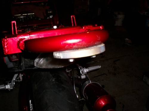

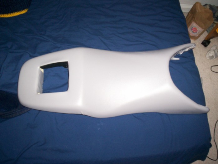

did the seat light gray today
it sucks, but that dual caliper wont last. Seat looks coo!
