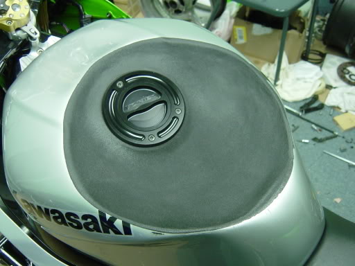

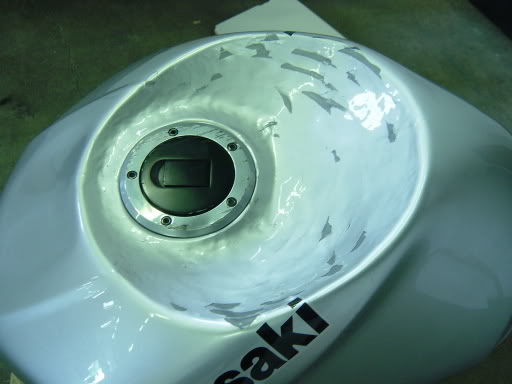

This is the first tank Ive ever dented

If you take your time, and invest in a dolly and body hammers that stretch the metal, and proper angle blocks you can dent a take really well. I used my phone book and dead blow to get the dent started, but I finished with a ball pean, block of wood, and patience. Dented perfectly!

Originally Posted by Wheeliest
did the regular cap leak?
Dont know I just put it on to dent it in, I already had the Vortex just thought the OEM would be better for denting becasue the lock kinda holds the **** together..
