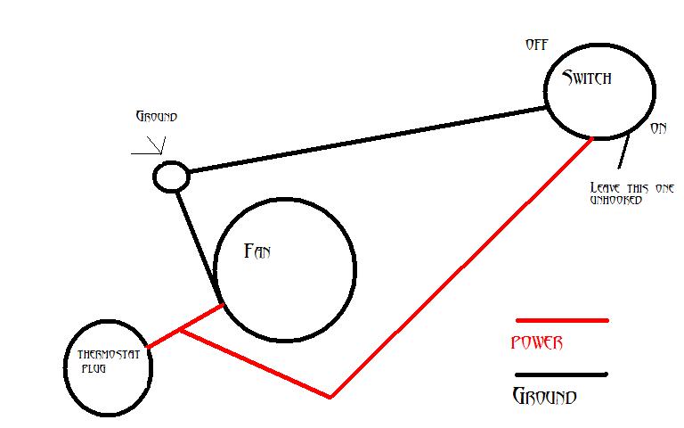

anyone got any pics on what to cut and where to tie it to so it stays on all the time? greatly appreciated

on the clutch side of the bike there is a sensor in the side of the radiator with one wire coming off of it run that wire to the ground on the radiator and your fan will stay on all the time! :YEAH

unplug it and jump it with a paper clip. it will run all the time when jumped, then take it out when the bikes off. or put a switch in line. otherwise it will stay on even when the key is off and out of ignition.

I had posted this before to help out someone else, hope this gives you a good idea....
Originally Posted by Beto
just drew this one on MS Paint. I hope this helps you out some man. Basically just splice the line that goes from your fan to that little plug on the radiator, and run a line from a switch onto it. If this doesnt work, just take your bike to someone you know that is good with electrical work and tell them to hook it up. OH yeah you shouldnt need a fuse this way. Mines hooked up so when the switch is on the fan stays on constantly, when the switch is off the fan works like it would stock. Good luck man...

the way i stated will run the fan only when the key is on there is no switch to forget

oh right right. I didnt pay close attention to the question he asked, I thought he wanted a switch wired to it
