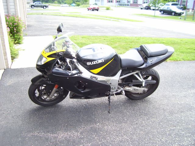

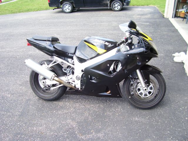

i just painted my lower fairings for my gsxr, i used black semi gloss krylon fusion like krohnszx6 said, i used a lighter steel wool to smooth out the plastics, it worked better than sanding cause it didnt leave any sanding marks, it just leaves everything really smooth, then i put like 4 coats on each fairing. the paint is really easy to work with, if you get a run or something, just hit it with a scuff pad or steel wool like i did, and re-coat the whole piece and it looks nice and even when it dries.
if it helps the steel wool that i used is "00" on the scale of light to coarse, here are some pics of the lower fairings after i got em back on my bike.
PS. the more time you put into making everything smooth and even, the better it will look
