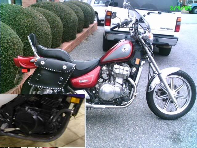

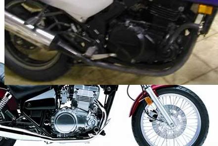

Turns out that the motor seized... We could get it to crank if we turned it by hand with a ratchet... but the starter wasn't powerful enough to do it by itself... anyway now we need a new engine... I can get one of these Vulcan 500 ones cheap... it looks like it matches up.. anyone know for sure? Thanx

i heard somewhere the vulcan 500 is a direct swap..not for certin tho

The EX/ Ninja 500 and Vulcan 500 use the same motor, just the case covers are different...at least I have been told. I am thinking they might have a different cam though, but everything else should be the same.

Sweet... thanx I just found this too incase anyone else cares...
If you need a replacement motor, and can't find one from a Ninja 500, look for a Vulcan 500 motor, or a motor from an older 454 LTD era bike, which came out before the Vulcan and Ninja lines did.
If you pick up an engine from a '96-05 Vulcan LTD, you only need to swap the cams, carbs (32mm vs 34mm), and the intake boots to get the engine to work exactly the same as your Ninja motor did when it was healthy. Heck, you could keep the Vulcan cams, and get more torque down low if you are willing to sacrafice a bit on top.
If you pick up an '89-96 Vulcan 500, you only need to swap the carb internals (needles, main jets, jet holders, needle jets) since they are the same size carb body. Same thing with the cams, although this Vulcan motor is much more powerful than the newer motor, so you won't be sacraficing nearly as much on top as you would with the newer version.
