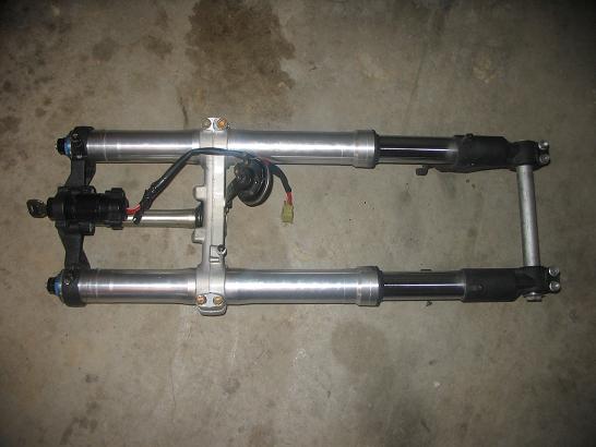

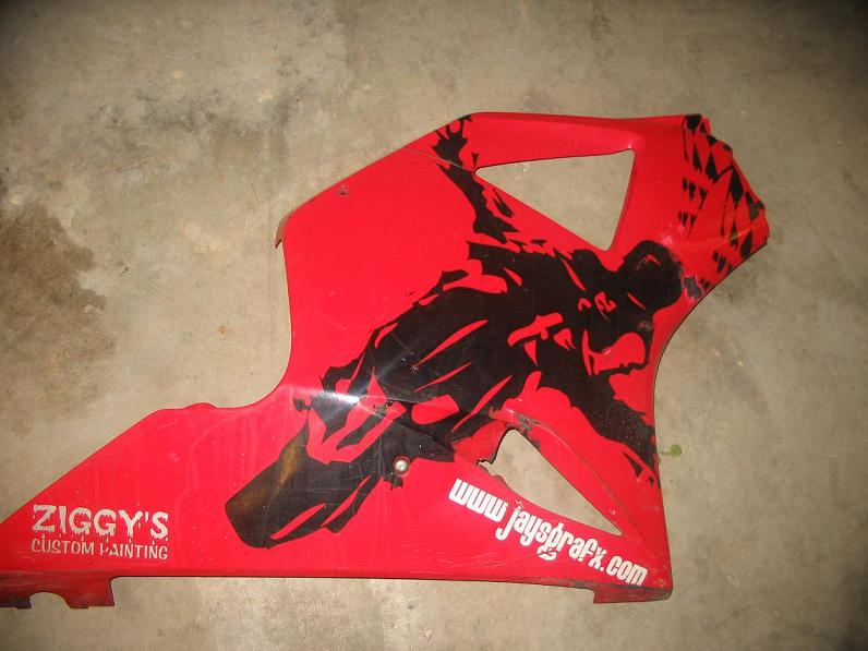

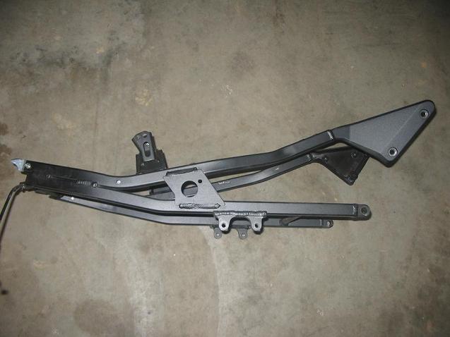

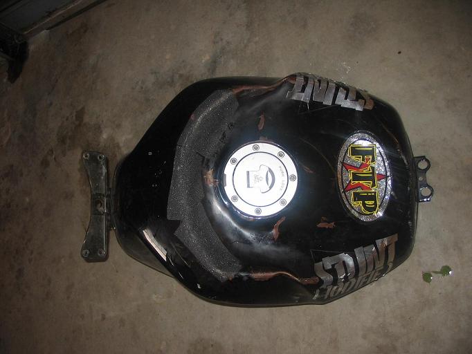

Re: -----929/954 Thread-----
4 sale....
dented 954 gas tank$$150
subframe $$250
left&right fairings..make offer
forks $$250

Originally Posted by FarleySF
4 sale....
subframe $$250
forks $$250
i will take the forks for 250.00 with triple
pm me with the details

Are all the tabs still on the fairings?
