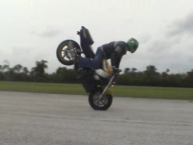

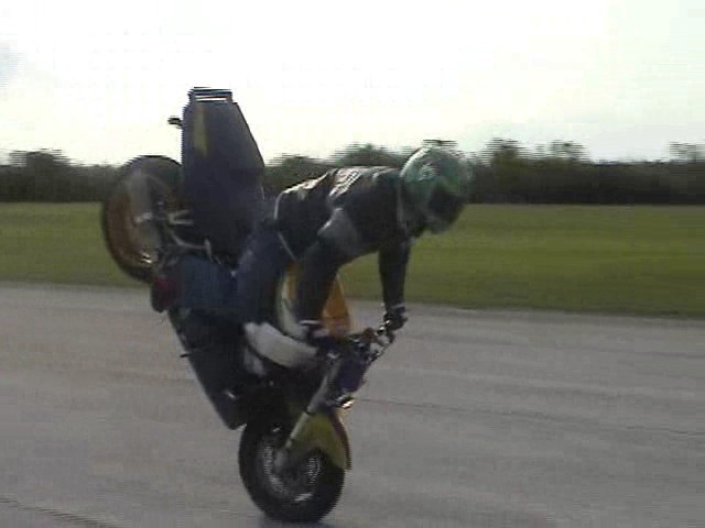

From that side pic... if you can get the rear seat up level w/ your head you'll be rolling some nice ones. Your back will be almost level w/ the ground at bp.

For height reference... OG stoppie master Gorka.
keep in mind though, he's runnin dirt bars.
