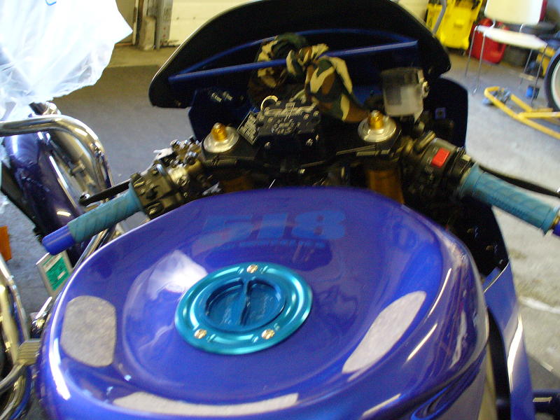

here are some pics of my teamate joes tank. mine will look exactly like this one soon!
Is that a cut,flip weld,or Bondo,cuz that **** is clean,damn good job.
thats a good job thast about as far back as you can get it

its not cut. it was dented in starting around the gas cap and working outward with a plastic hammer. surprisingly very little bondo was used due to the awesome dent job! then paint and clear and thats what you get when you take your time and do it right. its like sitting on a toilet seat, comfortable as f*ck!

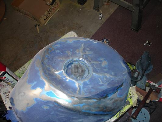

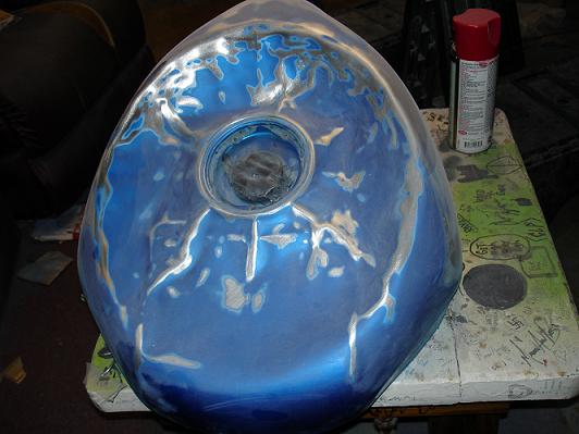

Mine isn't from a 636, and looks like **** but I thought, I just post it up It had gas leeks all over the place, but that's welded and after alot of trouble the tank is okay now I'm scared to dent in tanks in the future, I probably will **** it up again

heres a pic not that good of the tank though but you get the idea
