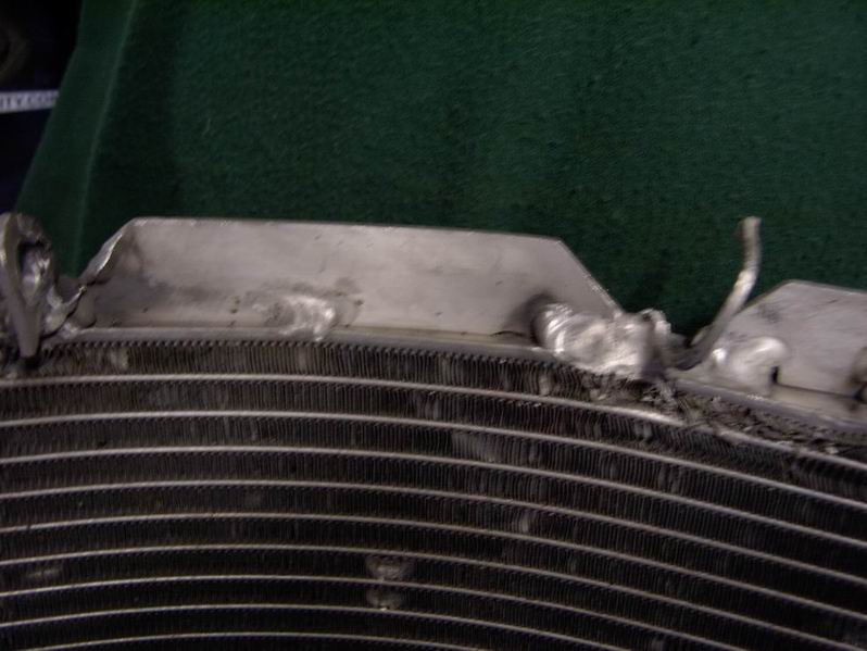

What all can I do to beef this up? Mine just ripped next to the weld on one of the tabs. I've heard of people reinforcing these, whats the best thing to do?

It can be a pain. I did mine on my 929 but they still have weak points. I couldn't think of a way to reinforce the ring parts. It held up to alot though.

Any other ideas? I'm thinking of just getting some longer pieces of metal, and using 2 strips (bent in l's going in each direction) rather than just one for each tab. I'm not a fabricator, but that seems like it'll make it stronger

drill the other mount out on your frame and use a bolt on both sides. Usually when it rips off it is because the tab side slips off and then rips the other side to pieces.

also make sure ur botto mounting tab is hooked up...so it keep weight off it and it wont rip the top ones as easily

i run straps around mine like you buy in a role at advance with the holes in it works great

straps to the bottom=best fix, exhaust (hose) clamps around inlets to frame= temp(or perm) fix

Alright, so I'm gonna drill the frame.. should I worry about tapping out the hole?

you don't need to tap it.just run a bolt all the way through.i also make the lower brace out of 1/4" steel and chuck the aluminum one,the stock one flex's.
