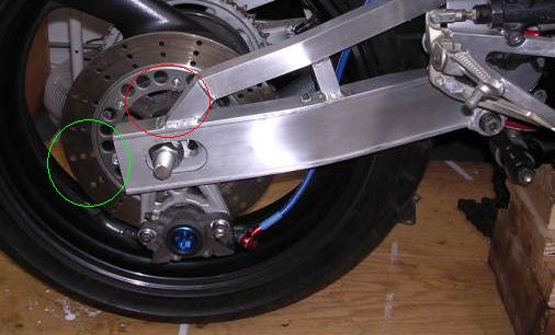

Is it easy for a welder to make a dual caliper bracket out of two stock brackets? On my 2000 R1 it would be VERY easy to weld two into one by putting one caliper at the opposite end of the other(red circle), but the swing arm is in the way. It looks like it would be tough to weld the second bracket to the rear (green circle) because there is not a flat spot on the rear of the bracket to weld up to. How does everyone else do this? Does anybody sell them? Racing 905 website looks like they sell them for the GSXR only.
(NOT an R1 in the picture, just all I could find on google for an example)

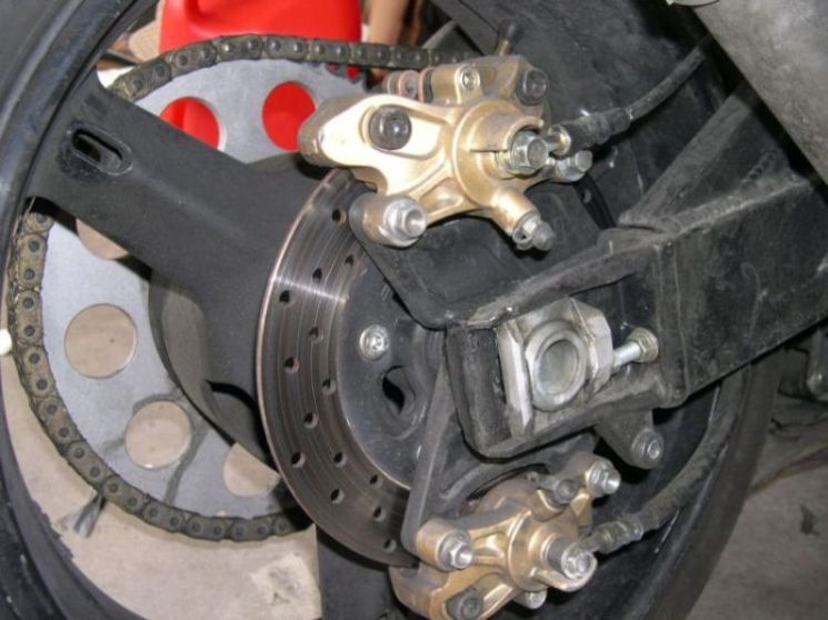

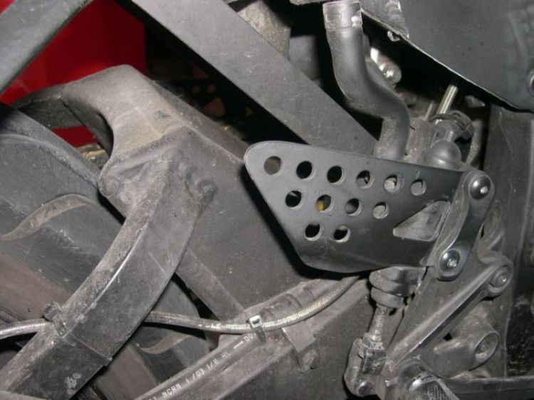

Old Nov 27, 2005 | 03:44 PM
808stunna's Avatar
Posts: 1,513
From: maui hawaii
808stunna is an unknown quantity at this point
Re: Dual caliper bracket?
SORRY IF THE PICTURE IS BIG.
Old Nov 27, 2005 | 09:24 PM
Regstunts's Avatar
DNFstunt
Posts: 4,503
From: Mississauga, Ontario
Regstunts is a decent person
Thanks man....that JUST fits on the top. Did you weld the two together??
Old Nov 27, 2005 | 09:39 PM
808stunna's Avatar
Posts: 1,513
From: maui hawaii
believ it or not the top caliper is where the factory caliper sits, teh bottom one is the add on. on your year r1 i think the bottom is the original? its not welded but i didnt have to weld it cause if you look at the second picture the swingarm is channeled fro the caliper bracket to slid in. the part on teh caliper bracket taht slids in is squared. so i basicly cut it in half and slid it in but. i should have cut it a little difrent, none the less it works so im happy. let me know if you need any advice. peace

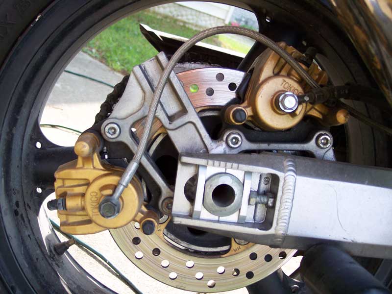

here is set up on my gsxr 1k
