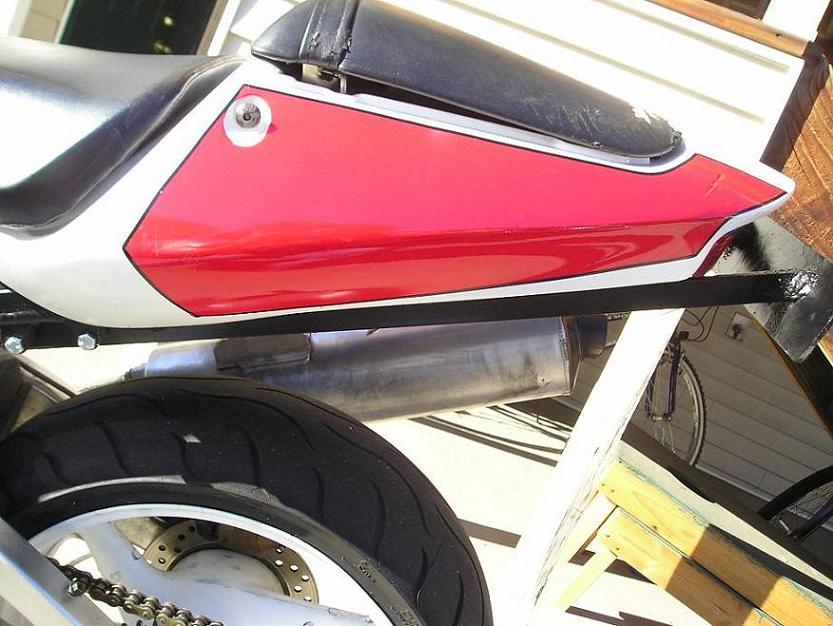

You have 2 options here... either (A) you want to keep your tail section intact and don't want to cut it up or (B) you don't really give a flying F U C K and will hack your tail section up to put whatever on there. Now, if you are like me and want to run a full tail section NO COMPANY OFFERS A BAR like this... so do what I did and build your own.
I have provided pictures to show you exactly what I did... and as you can see the plate is very close to my tail section and its a TRUE 12 O'clock, none of that bs 11:30 $HIT!!! You can see the two inner rails run inside the subframe and connect to the rear peg mounts, and then I welded a lateral bar for side-to-side support. It cost me $40 in materials and about 2 hours of my time and that thing scraped PERFECT. The trick to putting the plate on is actually put the bike on 12, tack weld the plate on there, then put the bike back down and weld away!!!
Hope this helps dude... it was super easy, and all you have to do is cut up your undertail a bit... no biggy. PM me if you have anymore questions.
