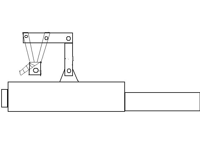

Just fab a bracket. Get a piece of metal, drill holes for both footpeg bolts, and then drill a hole where the exhaust mount is.

Re: Problem putting exhaust on an F4i...
**** I forgot that the stock exhaust bolts into the bottom of the footpeg.
