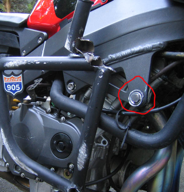

Old Aug 29, 2005 | 11:21 PM
kj's Avatar
kj
Posts: 2,277
From: South of Boston, 781
Re: Tip for 905 cage rollover problem
Originally Posted by jny
i asked aaron @ 905 about a slider for his cage. he said at this point it was bad idea. im thinking his logic was to much stress or added leverage to the motor mounts or threads.
Naw dude... that POS cage will rip apart before the motor mount threads give.
Old Aug 30, 2005 | 12:06 AM
Tony Carbajal's Avatar
Two Tone
Posts: 3,044
From: SOCAL
Tony Carbajal is an unknown quantity at this point
did u pull that part of the cage back or did it brake that far back. I have never seen a cage brake that badly before.
Old Aug 30, 2005 | 12:08 AM
Two Tone
Posts: 3,044
From: SOCAL
Originally Posted by got circles?
look you got them free,and you said i could use it,and you know im gonna give you another set.
No U LOOK, I was just messin with ya and i know u'll hook me up with another set cuz i hook u up with stuff all the time

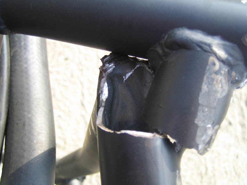

Old Aug 30, 2005 | 01:11 AM
kj's Avatar
kj
Posts: 2,277
I pulled the mount tube back for that pic, but it broke around all the welds and was just hangin there.
It looked like this before I moved the mounting tube.
