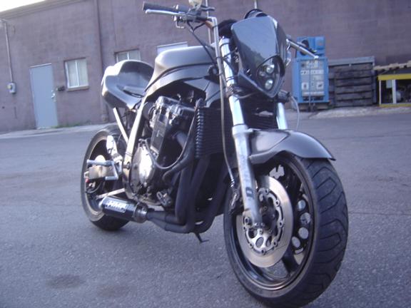

I have a Acerbis one. It's ok at night but not for back roads and ****.
Here is a good way to hook it up.
Take the plugs for your normal lights.
Make 4 leads using a male spade connector at one end and a female at the other end. Plug the male end into the headlight plug and the female end into the fightered head light.
Use the high beam lead and leave the lows out. Then you can turn your lights off if need be or have them on. Or run one for lows and two for highs. Even though they aren't bright enough to notice. lol
I used zip ties for mounting. The rubber **** mounts they came with sucked ***.

Originally Posted by T&A
Here is mine
nice you even kept your gauges, but can you make the pix a lil smaller next time

Originally Posted by UNIDENTIFIED
nice bike...
Thanks man.
