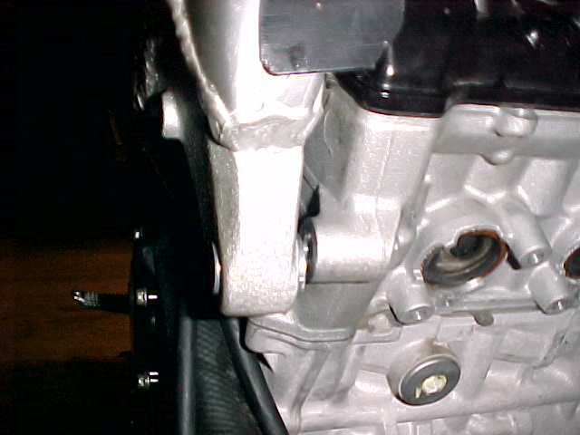

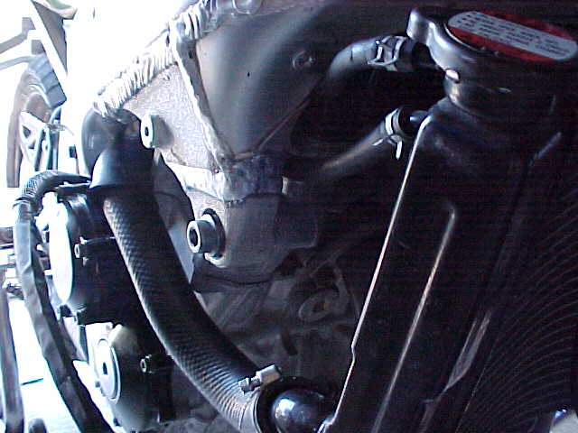

Originally Posted by Lb3
JohnnyP is incorrect. At least as far as the 01-03 600s are concerned.. As justin said above, you have to shave the front mounts for it to line up. It is most definitely not a direct bolt in. The 750 head is about a quarter inch taller than the 600 head. I know because I did the mod personally. I have before and after pics on my computer at home that shows how far the mounts are off.. and what it looks like after they have been shaved and rewelded. I'll post em up if anyone is interested.
please post them so i can get some light in at the end of this tunnel. It will aslso give me a better understanding of what to tell my welder.

heres some before pics... this is the 750 motor mounted in the 600 frame.

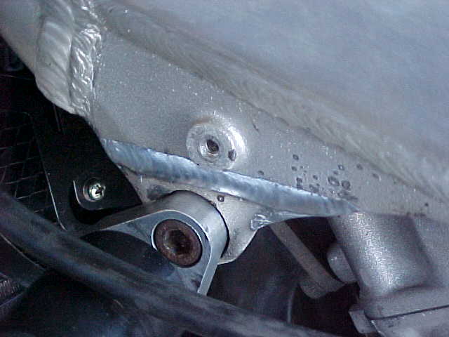

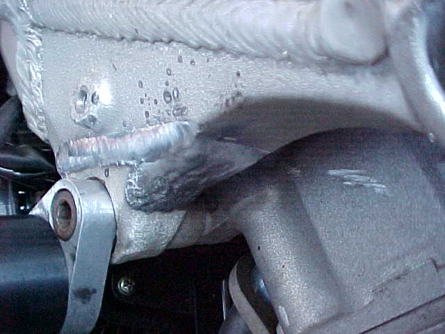

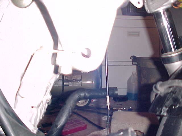

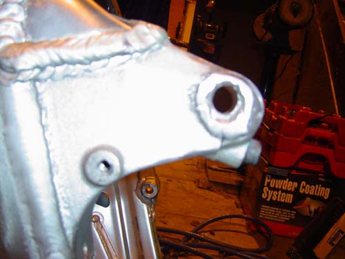

heres the after pics.

Old Jun 8, 2005 | 02:32 PM
BunaRocket's Avatar
Posts: 1,522
From: N,A
BunaRocket is an unknown quantity at this point
Re: gsxr 600 swap to 750 ?????
Perfect, exactly what it should look like. Lb to the rescue, hahaha
Old Jun 8, 2005 | 03:23 PM
OWA21's Avatar
Posts: 24
From: Mcallen, TX
OWA21 is an unknown quantity at this point
I SEEEEEE THE LIGHT :YEAH Looks like a pretty good weld job. i just hope my welder does the same.
