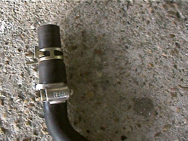

aight player you caught me in on a good day cuz i hate workin on my **** but i took it apart and hers my set up if this dont do it for you throw ur bike away 2 pcv valves small side toward the motor heres my tub and a pic of each end how i did it 2nd pic is bottom 1std pic is top ther is another small peice that goes on the bottom just like on the top its just not in the pics

small end toward the motor? ok that might be my problem them...
will it still allow the motor to vent?
i have mine set up large end toward the motor and that ***** jsut pukes oil when on the bar...

ya it still allows vent i drug mine on the bar on idle for a couple hudred feet and not one puff of smoke or one drop of oil

u can get them at any auto parts store use the same hose just get some pcv valves that fit in it cut it shuv them in and put clamps on it like in my pics there aint a drop of oil in my airbox
