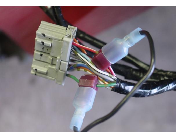

Old Apr 14, 2005 | 04:33 PM
atnuts's Avatar
Posts: 3,995
From: joi-zee
Re: tip over switch on f4i
here's a few pics of what I did on my 01 f4i...let me know if it's right
ID:	133208   Click image for larger version
ID:	133209   Click image for larger version
Old Apr 14, 2005 | 04:46 PM
kirk newcomer's Avatar
Posts: 1,792
From: New Holland, Pa
kirk newcomer is a decent person
Those Are The Wires I Did. So I Guess It Is Right. I Just Twisted Them Is That Right.
Cool Thanks For Posting Up
Old Apr 14, 2005 | 05:08 PM
atnuts's Avatar
Posts: 3,995
From: joi-zee
that should be it. Before I connected both wires it wouldn't even crank, bike was totally dead. After connecting them it turns over. I checked all the other connectors and they didn't have the 'red' in one corner and the 'green' on the other. So hopefully it's done right and that's the right connector.
Old Apr 14, 2005 | 11:31 PM
Posts: 1,792
i still don't have anything. the bike cranks but th fuel pump doest come on. if you look up two psots at the pic i spliced the same wires. the two little plugs by it i have nothing going into though. would that be it. or did i fry the relay in the tail sect. when the other fuel pump caught on fire?

Old Apr 16, 2005 | 09:18 AM
atnuts's Avatar
Posts: 3,995
From: joi-zee
I rode with some buddys yesterday and one of them had an 01 f4i and he had the same wires jumped like I have(same as in the pics) and his is running fine. So I guess it's right. If you have the same setup and it's still not running right obvioulsy you've got something else screwed up.
