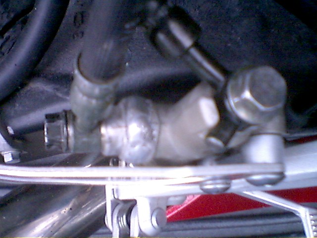

no no no!
in the picture is what i added. it is a better way to make a rear cylinder for single caliper set-up, as opposed to using a piece of plastic as a fitting.
the full-throttle cylinder however, would be the best. but were talking about CHEAP handbrakes. SO...
the DOUBLE BANJO BOLT is only used to make one long brake line from 2 short ones like this ---> o-----------o(banjo)o---------o get it?
