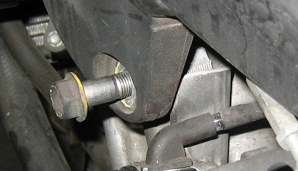

Its always something new breaking on this thing--2001 929---picture explains it all. The bolt is'nt stuck--its in perfect shape and loose. Engine block said bye bye. Any suggestions?

I can't really tell what's wrong from the pic....
Old Apr 2, 2005 | 07:59 PM
Armenian's Avatar
Posts: 3,519
From: Dallas,TX
Re: 929 Motor Mount Broke
Look at the engine side where the bolt is supposed to go--it broke off--you can see the threads.

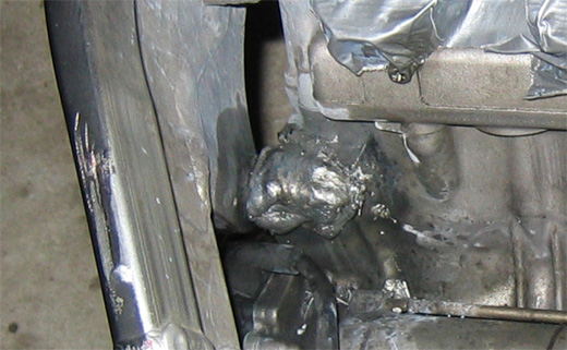

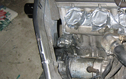

Okay gents its fixed...And I did NOT have to drop the motor to do it. I removed the tank, airbox and the throttlebodies. I covered the intakes going into the block with duct tape and brought the entire bike over to the welders. They used a wire feed--and there was plenty of room to weld with the throttlebodies gone. Drilled, tapped and now she'd going back together--Here's a pic--I dont know if it will come out clear though:
ID:	132238   Click image for larger version

holy uglyness weld!
i hope you didnt pay more than 40$ for that, none the less it works.
i m a TIg welder and want t brace my shiz just cause i fear situations like these

I was just gonna say you could of used a heli coil. From what i understood your bolt broke off in the motor mount right?? You can use a bolt extractor and pull out the old bolt. Drill the hole out and either re-thread it or just insert a heli-coil
Old Apr 9, 2005 | 10:42 AM
Armenian's Avatar
Posts: 3,519
From: Dallas,TX
no look at the pic at the beginning on this thread--the block just broke completely off--bolt was in perfect shape. I payed 50 dollars for that weld/drill/tap job and to have my radiatiors tab welded back on so I can stop using zip-ties. I dont care what the weld looks like--this guy I use is in his mid 70's and has been doing this **** all his life--his weld's may look ugly but his reputation around here is really really high--all the local bike shops use this guy. Hopefully this **** wont break--I'm just glad I did'nt have to drop the motor.

Nah, I wouldn't worry about his welds at all...he has that kind of rep. I have known him to weld on bikes and 4X4s without the weld breaking. That one does look ugly, but he probalby did that to build it up for durability, plus, no room to grind it down with the motor in place. Looks good...and yeah...your bike(among other things) breaks a lot!!!

You think that weld looks bad....... Wait till you get those sub braces........ EWWWWWWWWWW! But they look better than mine and mine haven't broken! :YEAH
