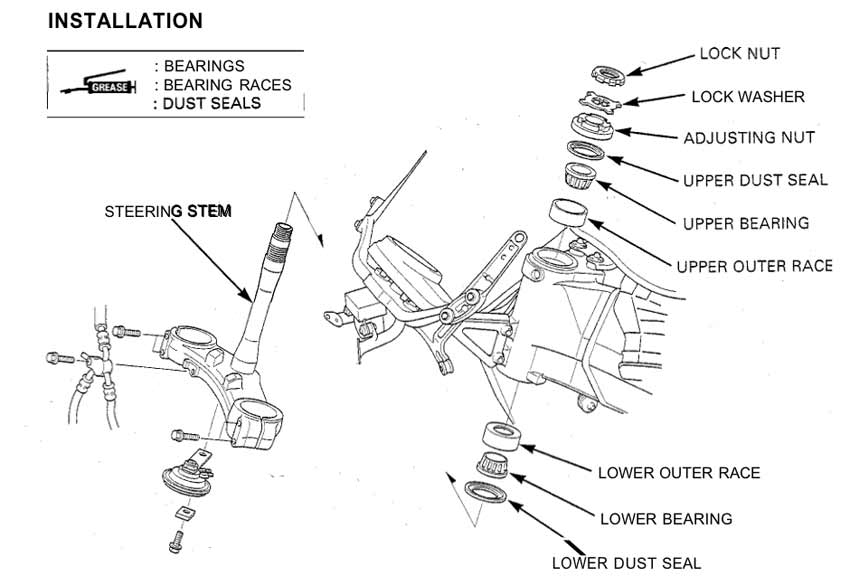

Old Mar 18, 2005 | 09:14 PM
Wheeliest's Avatar
Scrapes Elbow
Posts: 8,833
From: Phoenix, AZ.
Re: front end wiggle
wrongy wrong wrong wrong. Loose Tripple Buddy!... 954 has shlty head bearings... take it to a shop and have that shlt tightend. or do it your self.
