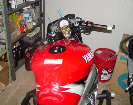

Originally Posted by FkingSUV
Howd you mount the guages with a fighter frontend?
I went to HOme Depot and bought a long strip of metal, the one that has the holes already pre drilled and is able to bend. I cut and bent the strips into a 'u' shape, enough to have the gauges on an angle/viewable, and screwed one end to the back of the gauge and zip tied the other end to the front fairing(you could use screws also). It's held up nicely. Not sure about your gauges though...my R6 gauges was easy 'cause it has 3 mouting points that just use screws. My brother has an F4i and did the same with his gauges.

Old Mar 1, 2005 | 10:38 AM
FkingSUV's Avatar
Posts: 111
From: White Plains, NY
FkingSUV is an unknown quantity at this point
Re: gauges??
nice bro, stable enough when commin down hard?
Old Mar 1, 2005 | 11:28 AM
onsighter514d's Avatar
Posts: 263
From: Centennial,CO
onsighter514d is an unknown quantity at this point
Re: gauges??
Yeah, how stable is it? I assume it wiggles a bit, but not too bad?
