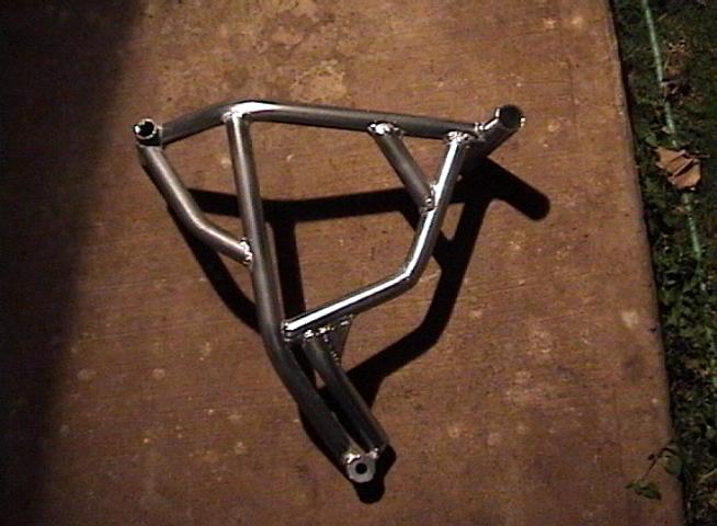

if you plan on making your own cage you can try makin it like the 905 cages aor you can try to make it like teh freestyle or you can make your own. heres one that i made for a zx7r

Can you guys post more designs. I plan on making the cage myself. Also, should the cage have any weak points? So that in hard falls my cage wouldn't damage my frame in the spots that its attached to. Would weak bolts or something work?

use grade 5 and below. grade 8 bolts will rip your threads out.

the cage posted above is probably the best design out there as far as strength goes.
Check out racing905.com and mxdcages.com for pics of there design's but there very similar to that one above.
Only other design option out there really is the Freestyle Ingenuity cage which alot of pro's run but i think the other design looks stronger.
