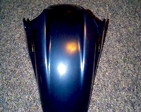

Heres my front fender i finished today.
I sanded the original paint down with 200 grit (not all the way to the plastic) then sprayed on 2 layers of primer. Sanded the primer with 600 grit then sprayed on 2 base coat layers of blue. I thought i was finished and wet sanded. After the wet sanding i noticed that it lighted the spray paint alot and made it look like ***. So i sprayed on a 3rd coat of blue and just left it without sanding and it looks great! Im guessing the reason the wet sanding didnt work out so well is because the spray paint has a glitter in it that kinda sparkles.
I wanna do silver tribal flames really bad on the rest of the bike. Has anyone had experience trying to lay out flames and use spray paint to paint with. I tried drawing on the flames on the primer for the front fender and decided that there was no way i was goin to be able to mask it off. I wanna "freehand" some on the sides of the bike with some of that thin vinyl tape. Im atleast goin to attempt it.

try and get some very thin (less than 1/4 inch) painting tape and try taping off the sections you want to paint flames onto...ive seen it on tv and looked like it would work
buddy of mine just rattlecanned flames onto his sv1k and i think it looks sick, good luck with it
thin pin stripe works too..mask it off ..takes a little time but it can be done goodluck

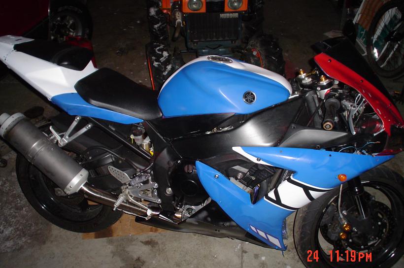

my 4th rattle can job
yeah see i was lookin at some of this stuff at the auto store when i asked for "thin vinyl tape to mask flames off" he said all he had was 1/2" stuff. I seen the pin stripe stuff but didnt think about it (DUH) ill go pick some of that up. Im assuming it will leave a nice clean line
Im having fun with this haha.

are you painting the rest of the bike silver and leaving the flames blue? If you want silver flames then pin stripping won't do **** for you. I'm not sure what you're lookin to get here. If you want silver flames you have to mask off everything you want to stay blue... The 1/4 inch blue painters tape works really well. put some newspaper behind it as well to handle to overspray. And be sure to post the pics when you're done!

tape off what u want for flames... then tape the entire thing off then cut out what u wanna paint

Try drawing the flames on a bigg piece of paper/whatever and cut them out, then just put that as a mask over plastics without being close-tight with plastics, and spray it. Because there's space between plastics and mask/paper the spray will spray around little bit and you'll get something like airbrush effect...
P.S. just try it out on something else first to get the hand of it, and to not ruin your plastics with it first time...
