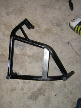

Had a good friend weld up a "stator guard" on the powers cage today:
If the pic sucks, the little support bar going across the bottom is pretty thick--3/8 inch....

While we were at it, he welded a 3/4" yes....3/4" inch thick steel bar to the skinny powers plate--together, its 1 1/8" thick. :YEAH :YEAH

that support bad is directly over the cover is it ???!!
Old Jan 26, 2005 | 07:24 PM
  #39
Armenian's Avatar
Posts: 3,519
From: Dallas,TX
Re: Dumped 929 w/Powers Cage-Busted Stator Cover
somewhat over--It'll be a few inches away from the cover...
