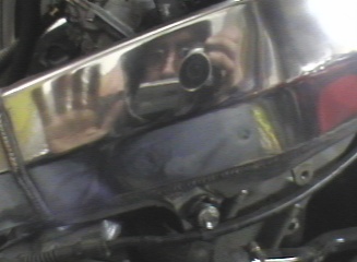

to get the whole thing to look like this.........looks pimp but way to much work
Name:	mike bike2.jpg

step1. strip all paint off
step2. sand until smooth w/150-200 grit
step3. sand until smooth w/ 400 grit
step4. sand till smooth w/800 grit
step5. sand till smooth w/1000grit
step6 sand till smooth w 1500 grit
step7. snd again w/ 1500
step8. sand w/ 2000
9. sand w/ 2000 again
10. sand w/ 2000 again.........lol get the drift?????????????
and if u want go to 2500 - 3000
then apply polish at this point it will look like a mirror
BUT BEWARE IF U WANT IT POLISHED U R LOOKING AT +15 HOURS A WHEEL
or longer.................
i only went up to 1500 on my bike cuz i dont give a

this is what it shud look like its a zx9, the pic kinda sucks, and the lightings bad, but it will look like this if you follow the directions i posted. the pic. doesnt do it justice, and you DO NOT grind the welds down anyone should know that..you can lightly sand over the welds to give it a shine without affecting the weld at all......2cents
Name:	frame refection.jpg
