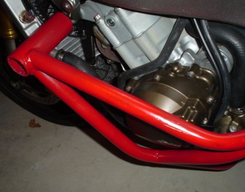

wow...from the looks of things, it sounds like it's hard to get in touch wit 905. i did it eeeeeee-bay
