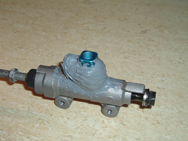

I got the GP adaptor too. But instead of the hose clamp which dont work, (Schwartz trust me, curt did EVERYTHING and that didnt work), i put some JB weld on it, that should not make it flex!!! JB is some serious stuff!! Then i got a zx7 hydro clutch lever. The lever has a NICE feel to it, just need a brake line and im ready to roll.

LMAO!!!! I got mine for free from IBWS bro. BUT, Moto-heaven.com has um. Hit up Phil and tell him IBWS told ya, i think there like $20
