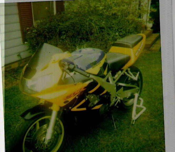

i WILL TAKE A PIC OF MINE AND POST IT. I PUT A 00 929 UPPER, HEADLIGHT BOTH SIDE MIDS AND THE TAIL ON A 95 900RR. THE TAIL WAS SIMPLE JUST USED WOOD SCREWS TO HOLD THE SEAT TO THE SUBFRAME AND THE PLASTIC JUST SAYED IN PLACE. I ALTERED THE 929 UPPER FAIRING BRACKET AND IT BOLTED ON LIKE NORMAL THEN ATTACHED THE 900RR MIRROR BRACKET TO HOLD IT ALL IN PLACE NOW THE MIDS,NOT MATCHING UP TO THE 900RR LOWERS SO I GROUND DOWN THE EXCESS LIP ON THE PLATIC A ZIP TIE HERE AND THERE AND IT LOOKED SO GOOD IT FOOLED ALOT OF PEOPLE. THE ONLY DOWN WAS THAT THERE WAS NO ROOM FOR MY 900 GAUGES AND THE HEADLIGHT WAS KINDA POINTING TO HIGH BUT FOR A SUNT BIKE WHO CARES.

i ONLY HAVE 2 PICS AND THEY WERE TAKEN WITH A POLAROID BUT YOU WILL STILL BE ABLE TO SEE WHAT I DID TO IT. I HAVE TO FIND A SCANNER TO PUT THEM ON MY COMPUTER WITH, BUT I WILL TRY TO GET THEM UP TONIGHT

maybe this will work? Yes i think it did i NEVER SAID IT WAS PRETTY :YEAH

hows the gap between the rear seat and fairing. ?
hows the gap between the front seat and fairing ?
**** looks good.
thanks for the pics,.

There was no gap between the rear seat and fairing but there was a small gap at the base of the seat but if i would have used a 929 seat i think it would have fit perfect
