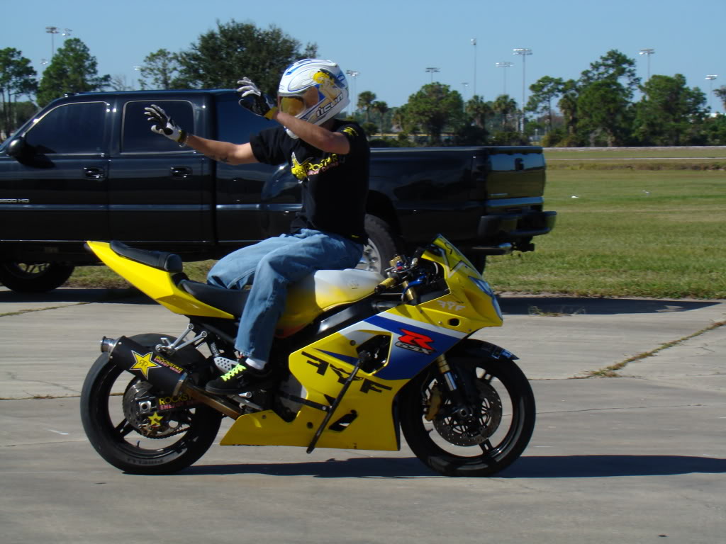

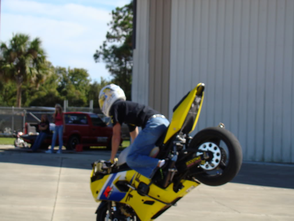

hand brake, idle screw, cage. add extra oil (I used respol 5w-50 and LOVED it)
Cage: I liked my freestyle ingenuity but most don't. Powers sucked, 905 was too weak, sick innovations or impaktech are always the way to go.
12 bar: subframe is super weak, get a round bar and powers subframe ties. impakteck makes a nice subframe cage to beef it up if you want a 12 bar. I rocked a scrapeworks subframe (tubular steel) and had a custom roundbar welded to it. it was so clean and strong but they are VERY rare and I already sold mine lol
Hand brake: hohey or 905 dual caliper all the way. you'll never be upset about it. brembo master or magura clutch master for sure. I used a gsxr radial master and it had plenty of grab and feel for the dual caliper.
sprocket: I REALLY liked -2, +15 on my sprockets but I stunted just as fine with stock front and +5 in rear. your basic -1, +2 is nice too just gotta have some extra room to slow it down and a little more clutch finess.
I used a thread kit and ran an idle cable off a 600rr and it worked great. also hear there is an old suzuki with one that matches the thread but I was too lazy to find one
I really liked the otown dent too because it kept me pretty far back from the bars. and make sure to keep your throttle cables tight, they seem to always have slack from the factory.
