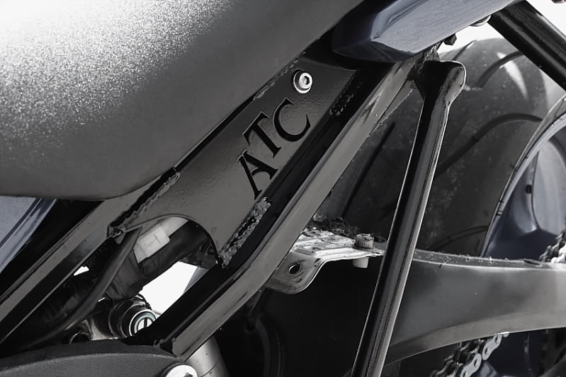

Quick question, I was looking at Zeus' pics of his Atown sub. What is this pictured attached to the sub an addition frame brace? Or was that supposed to be there because I don't have that for sure. Figured I'd ask now so maybe i'd have an answer by the time I get off work to go mess with it.

idk if this is right but....i think that is an older design. mine doesnt have it either and honestly done need that brace.....this sub is diesel!

Yea I guess so or maybe something else Zeus had. Either way doesn't matter. What matters is I got the damn sub mounted up and ready to go. **** YEAH!!! I tried installing it the way you did but I guess I didn't hold it up enough again, it lined up better but still a little off. Was kinda hard to hold the socket wrench the open end and the sub at the same time. Anyways ended up just putting the tank on with everything finger tight, put the GPR mount on the tank and screwed it down on the front then mounted up the rear. Then I torqued down the rear mount on the frame pulled the tank and tightened up the front. Now just to go buy a new dremel to cut the battery tray because my step dad burned mine up. He picked it up this morning and was toast by the time I got off work and went to pick it up.
