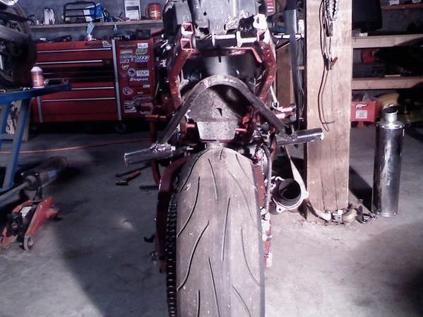

Re: Subcage question....?
This is after some straitening but its still way tweeked!
the bike is standing strait up,its jus the subframe and subcage that is tweeked.
wish i would have allready bought the OMR subcage and sold this solid one
I think some swingarm sliders and the OMR subcage would be the ticket for sure.
Darn it omr, i wish when you shot me the price...i would have jus ordered it!
Now i need a subframe AND a subcage!
