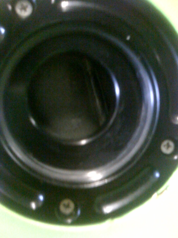

here man look its not there pretty bummed

Old Feb 1, 2009 | 07:23 PM
T-NECK's Avatar
Hate Hate Hate!
Posts: 9,133
From: O-Town, FL
Re: MOD vortex gas cap to prevent leaking?
damn, is it a true vortex cap? or a knock off?

Old Feb 1, 2009 | 09:22 PM
T-NECK's Avatar
Hate Hate Hate!
Posts: 9,133
From: O-Town, FL
its a true vortex i ordered it from HAI
wow i dunno then man, there's really no option if there's no way to vent the cap, other then quicksteel the outside, perm. affixing the lower base to the tank...thats what i had to do on my 636 to get to stop leaking..

Righteous 1's Avatar
Posts: 5,896
It really doesn't matter if there's a vent hole or not. The caps I've had w/ vent holes, I've had to JB weld the hole shut to PREVENT leaking. If your cap is leaking w/ NO vent hole, then the rubber seal isn't sealing/seating correctly. This happened to a friend of mine last weekend, and the problem was that the base wasn't mounted in the correct orientation. We unbolted it....realized it needed to be spun 90 degrees, and bam....perfect seal. The fill holes are'nt centered on some models and you gotta check em' out pretty close to determine the correct mounting position.
