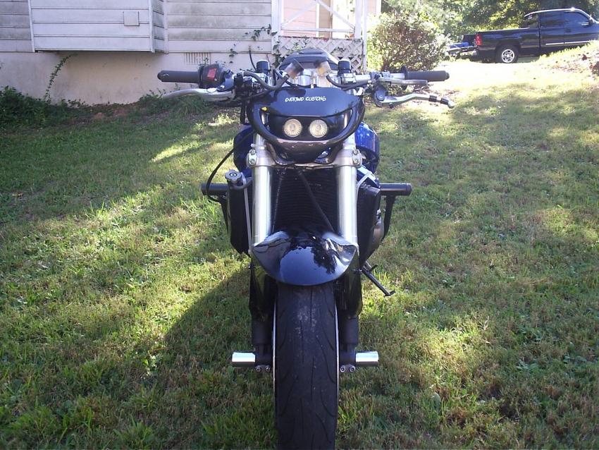

I'm Re-doing the good ol' F4i this winter and have been seeing the pegs on the front forks and some on the swing arm and just wonder what people are using and how to mount them?

I use an all thread rod and modified BMX pegs

So you've replaced the stock axle with just a threaded rod and put nuts on either side? Does it hurt anything to do that?

no you slide the all thread through the axle

no replacing the axle, you put the all thread through the axle!

Duh! Sorry had a dumb *** moment how are the bmx pegs modified you shorten them a little bit?

How long should i make them and is there any down falls to doing this will it bend my forks on a hard fall or anything of that nature?

any pics of this ??

Cut down bmx pegs, some all thread and two nuts
The nuts that goes into the axel is left off so the all thread can go through but the nut(s) that hold the pegs on pretty much takes care of that, just an FYI

do a side view of it up close

as long as the pegs are not wider than your cage you should be good.
