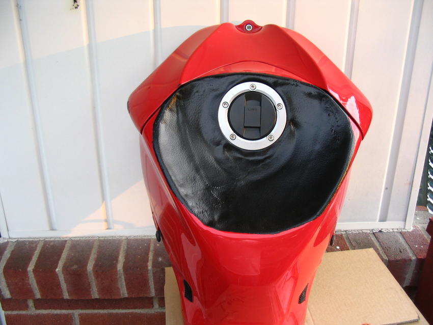

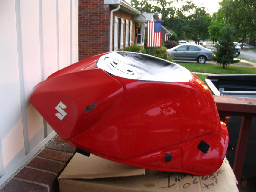

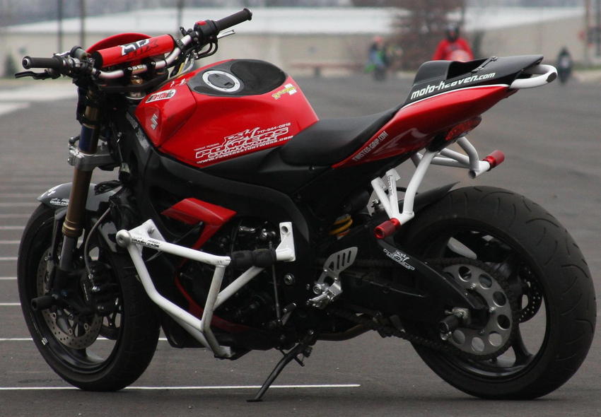

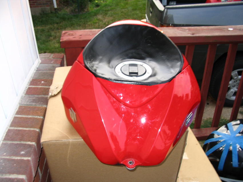

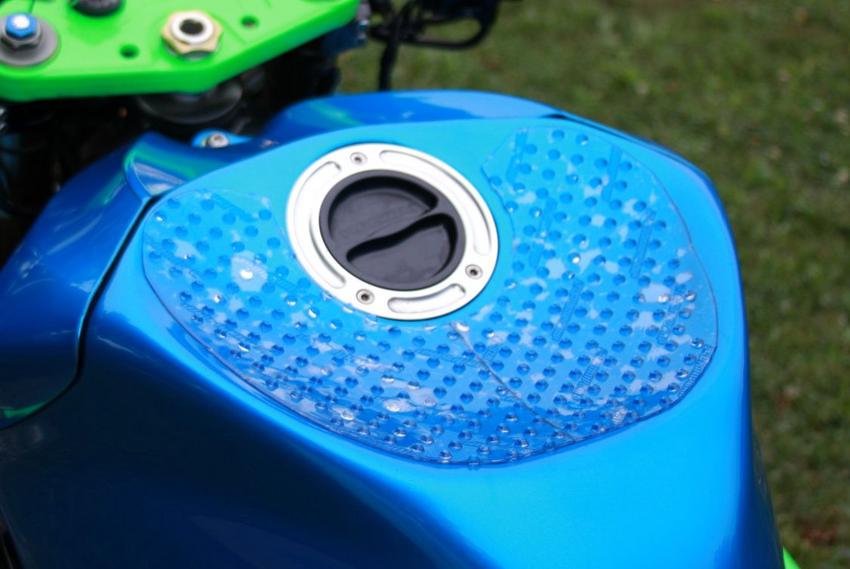

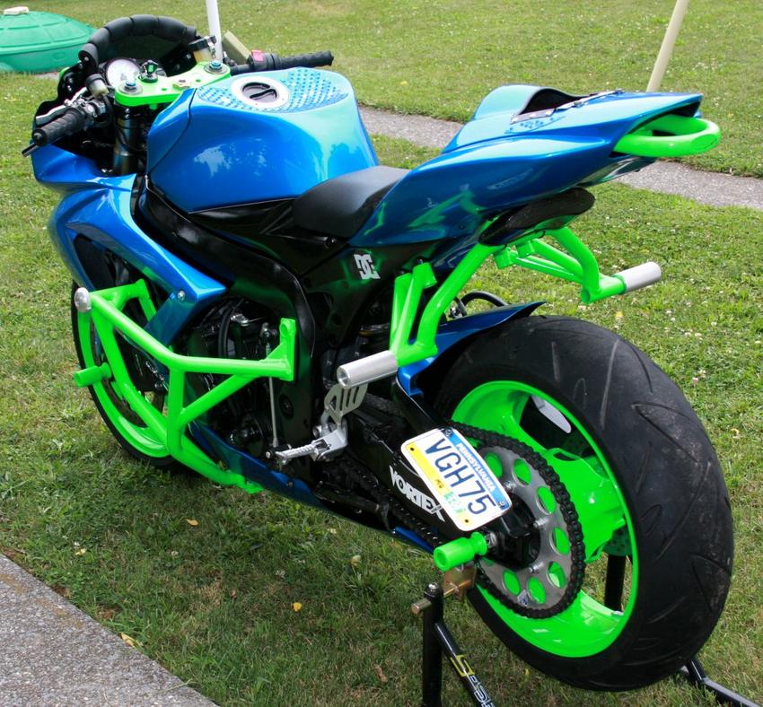

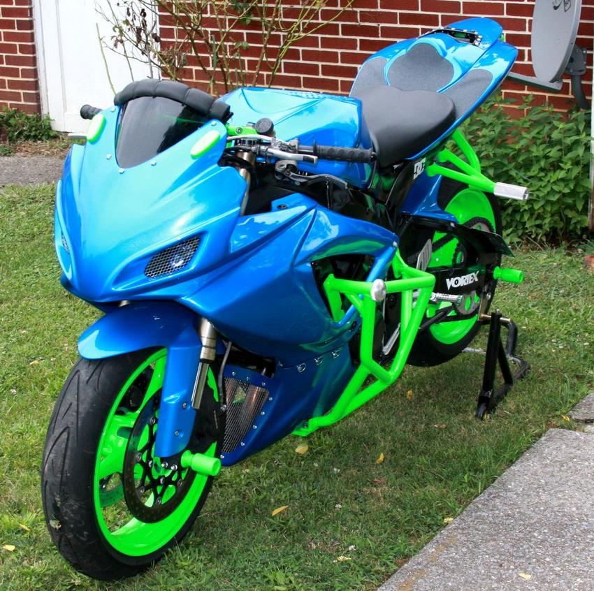

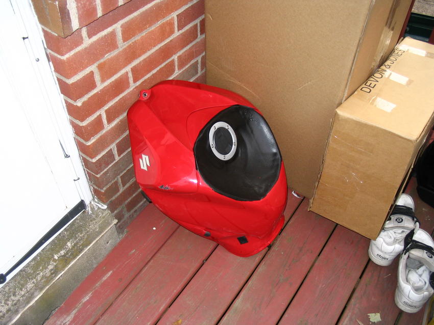

start by getting some friends to hold the bike straight up...dont leave it on the kickstand...stand on top of tank and jump on cap..use heel of foot to start cap...get that down pretty far for a start....then use a sand wieghted platic mallet...(not a rubber mallet) use the hard plastic kind with snad in it..like 5 pound dead blow..then beat around working from inside to the out...when u get the dish just about done get a ball pien hammer and smooth it the rest of the way out...chances are u might need a new gas cap when ur done..happens to alot of people...a: becuz u crack the cap, or b: cuz the cap doesnt sit staright anymore and leaks....get a vortex racing gas cap and it wont leak...heres some pix
God love this f-in bike......but that bit*h in the center fold of Playboy ha ha ha

Re: how to dent in a 2007 gsxr gas tank
Originally Posted by kah707
heres some pix
that's a sick lookin piece!

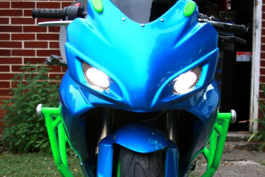

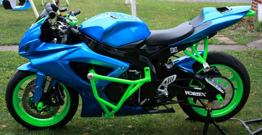

DONT KNOW IF U SAW MY BUILD UP THREAD, BUT I FINISHED MY BIKE AND REDID IT FULL FARING..came out way better then i thought it would of...im gonna keep it pretty and get a 636 streetfighter now...im taking donations for my new bike...switching from dirt bars to clipons sux..im struggling now
