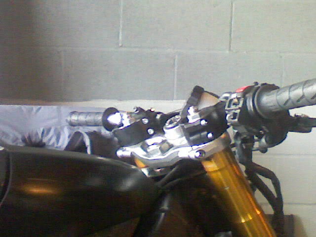

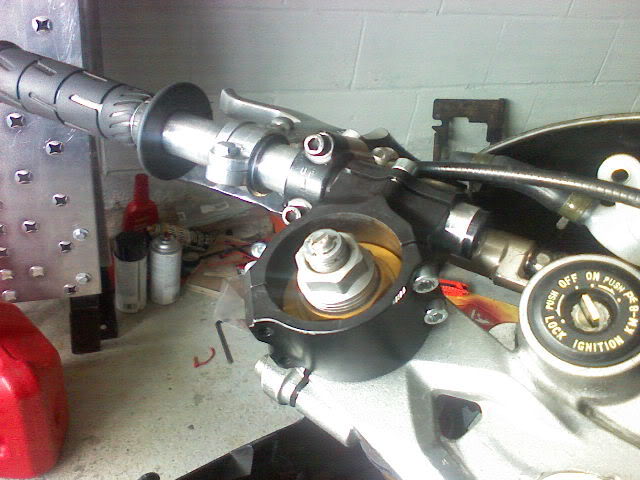

can somebody help me out with some options of what i can do....i wanna get a better setup....right now they are kinda close but my clutch is to high and i can't put it down lowier cause my handbrake can't go any lowier cause it hits my ignition....confussed?
should i try flipping the tripple....or relocating the ignition....thats my question...these pictures are all i got for now im at work....

have you tried turning your clip ons in towards the tank? or does the rb stick out to far to turn it?
i cant see the handbrake/clutch to good in that pic
that setup looks pretty damn clean the way it is

have you tried putting the handbrake above the clutch? i know 1 guy that rides with it like that and he wont do it any other way....

they are close enough to work both...it's just the clutch is just higher then i would like

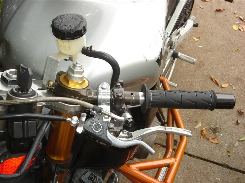

heres mine and i like it

that looks good....but i have a ******* retarded master im using....i can't set the clutch up on the inside of the handbrake....

oh i see, look on ebay i got lucky on this one i only paid $60 for 1000rr master

i actually turned my clip ons out a little and it gave me room to move the handbrake down....it's really good now...
