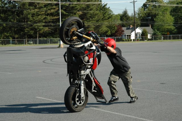

Any pointers or advice on stopping a wheelie and standing behind it besides the fact that i already know you have to pull in the handbrake and clutch at the same time. I can do merk steps, i just can't grasp the whole grabbing both handbrake and clutch. But anyway what i'm getting at is i wanna stop the wheelie and be able to jump back on without stalling. Any advice?

kinda like in this picture
