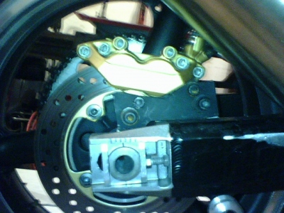

Re: Dual caliper or Gp tech adapter
I'm confused? How would you run a line to work both rear calipers? Pics would be great!!
Old Apr 16, 2007 | 01:28 PM
run the same set up you have now just add aline to connect the two calipers so they work with the foot or hand brake.....
it will be almost like having a bigger stronger caliper like this
