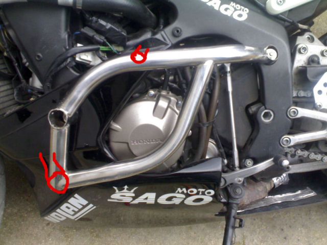

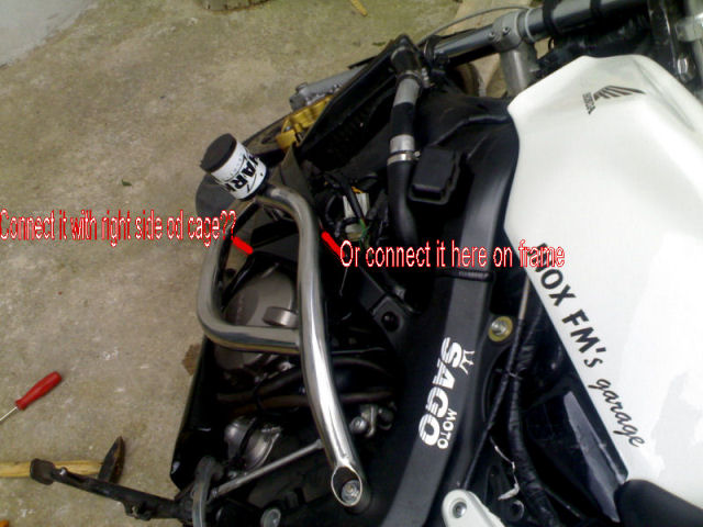

here is my cage, it works perfect but I woul like to catch it on one more place .
Now is on two
I dont know should i catch it on frame(like on pics), or connect it with another side of cage under the exhaust and oil filter
bike is 600rr

sorry guys but something was wrong with forum
i tryd to write new thread for a few times and it didn"t work
now is on three places

so this is personally made huh?
I say do both. the more support you have the better. I have bad luck with cages and ripping frames a part, so If you are only going to do 1 option. I would most likely go with attaching the back part of the cage with the other side of the cage.
Def. lemme know what the outcome is. Looks good man. Good work.

go with both

stiffer the better .......both

Stiffer the better, but also the higher the better. That cage looks like it sits really low on the bike, and the problem with that is the bike will roll up onto the clip-ons very easy. Try putting a higher mounting point on there for your 2nd "catch" point but also use that point to put some sort of delron slider or possibly a spring loaded slider. Just something to help prevent the bike from rolling up over itself.

it"s built to dont alow rolling. i can put bigger slider (this black plastic)

see now where is CT Stunt when you need him i would also do both.now that looks like a nice cage.i wish you made one for a 900rr.good job

Good points, but higher mounts on a 600rr isn't really an option.
