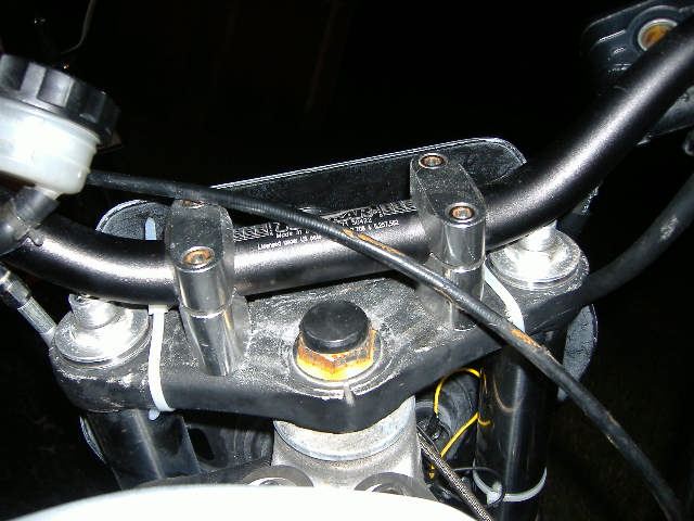

i have renthal bar clamps with renthal fatbars drilled into my stock f4 top clamp and those are pretty comfortable when standin up and ridin,and only cable that needed to be legnthend was the clutch cable, ill get pics up soon. Also i dont know if the f4 and f4i top clamp is different or not.

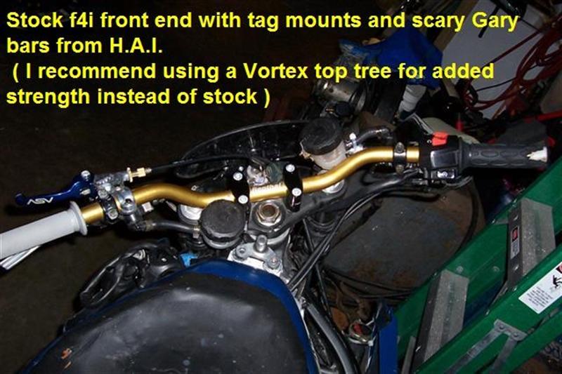

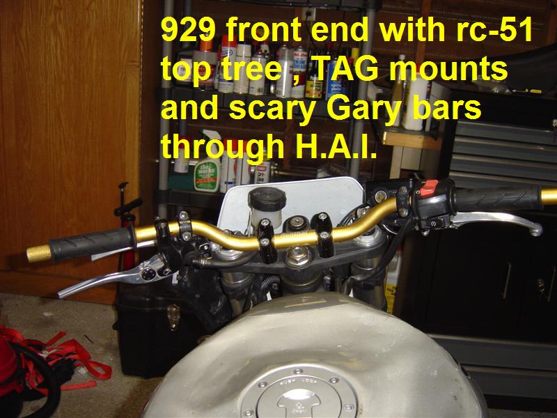

Buy a Vortex top triple tree if you want added strength use tag mounts and my choice of bar found through HAI scary Gary bars. Check out the HAI web site I think you can get everything through them and they are fast on shipping.
You shouldnt need to buy longer lines all of mine are stock rocking a 929 front end with no problems.
www.haibikeshop.com
Name:	1 (Medium).jpg
ID:	183772   Click image for larger version
Name:	stock f4i (Medium).JPG

fatbars with renthal clamps
