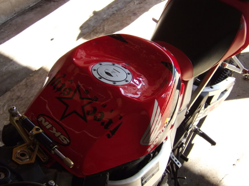

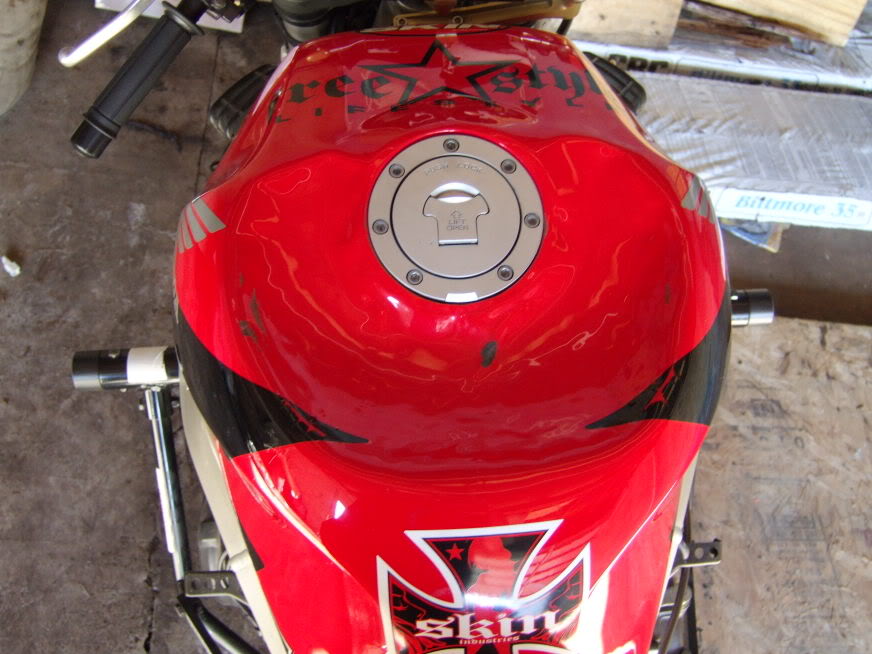

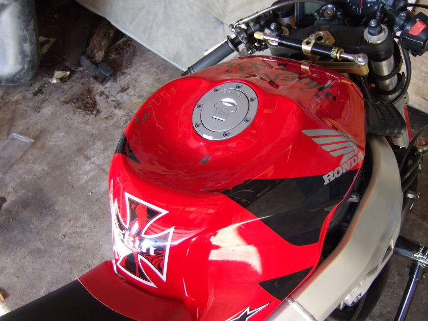

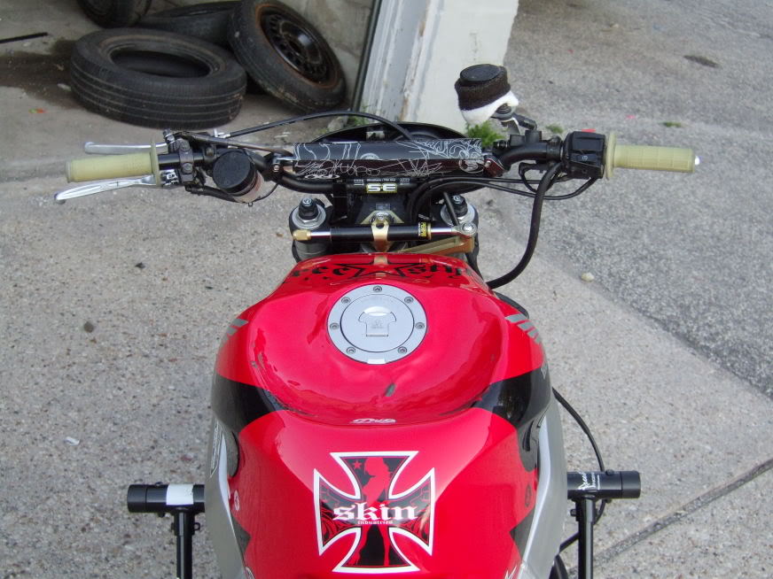

Mos def do it on the bike. And don't use a mallet, use a dead blow hammer. Use a phone book to start on the gas cap. Once thats down, use the hammer to move out the edge's. Here's mine on my 929.
