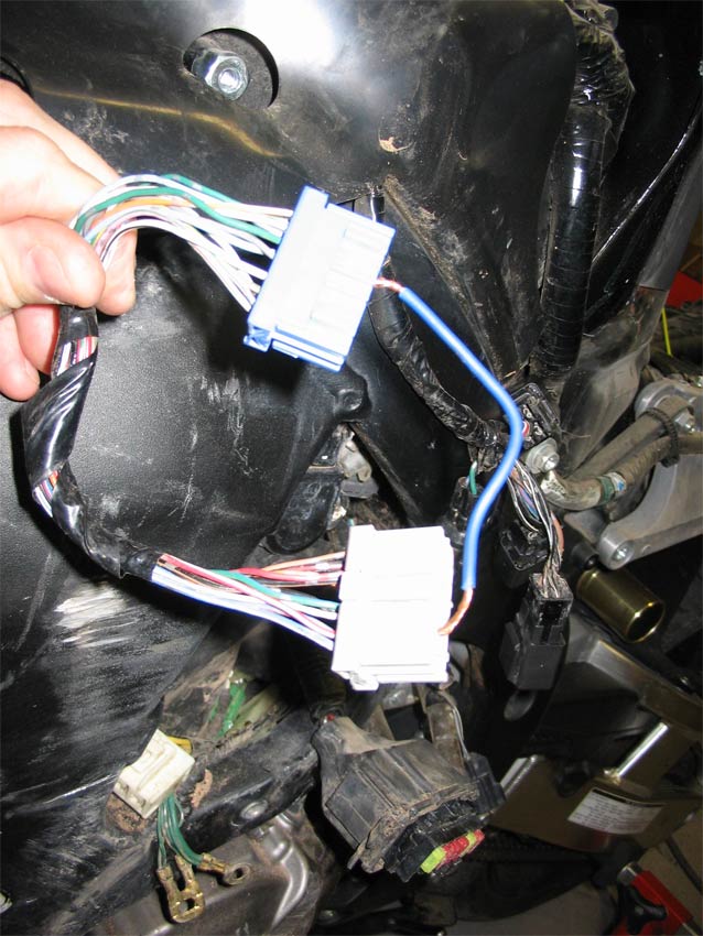

So i need some help with canceling out the guages on my 04' 600RR, when i unplug the harness from the guages the bike will turn over but the fuel pump and such does not turn on and the bike will not run, any advice would be much appreciated:YEAH

tip overis already taken care of, im talking about the actualy harness with the headlight plugs turn signal plugs and the big gray and blue plugs, just alot of mess to hide , id post apic but for some reason i cant use html code to do so

ok.. with hondas u need to jump the harness.. i don't know exactly which wires on the 600rr, talk to wheeliest, he'll tell u.. pm him

Mmmhmm i'll post it alittle later tonight what wires to jump on the main harness when i get home.

hes Unpluggin the entire headlight harness on the left side, that two large harness blocks... which jumping the reg tip wires is pointless since its no longer connected etc..

ok so yeah heres what i promised, now remember to match up the colors on the harness, like pay attention what colors are near the green wire so your looping the correct wires.
Connect the R/W (Red & White) to the G (Green)

ohhhhhhhhhhhhhhhh i c minus the whole harness....... why just not tuck it in the air box or hide it......... or jump the wires.........

why run the entire headlight harness when u can just jump these two and tuck just these into the airbox..

so what your saying is cut all the wires and just connect the green to the red and white and viola that will complete the cirlce of contenuity

dont cut anything, just connect those two wires together and tuck the harness into your airbox

here ya go
