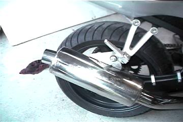

Re: Making a shorty pipe?
Originally Posted by addicted2psi
so what do you do on a pipe that isnt riveted? I plan on using a stock F4i pipe...how hard is that?
weld it ---> it's easy
