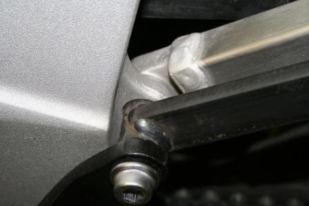

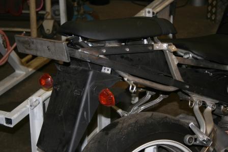

here is another reinforsment on a 750-03
Name:	2006-02-21 059liten.jpg
ID:	177577   Click image for larger version
Name:	2006-02-21 036liten.jpg
