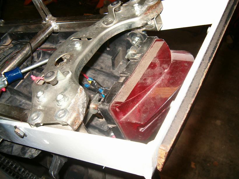

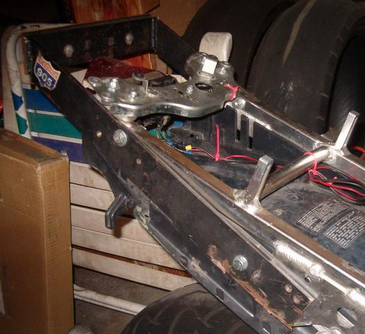

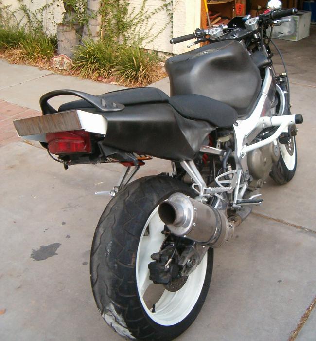

hope this helps, this is bannana seat sub w/ a split seat brake light
remember, these are stunt parts not factory parts,so your always going to have to grind em or beat em w/ a sledge hammer to mount them
Hell yeah, never thought about bolting it to the plastic **** undernearth the tail.
Thanks bro!
Thanks bro!
no problem man , BTW those little brackets I used are the brakets from single seat brake lights.
