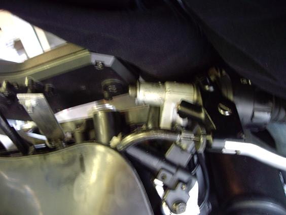

I wanted to keep the stock clipons so I extended my stock bar. Just wondering if anyone else has done this. I had vortex clipons before, but I took em off to use on another bike, and I hated using them upside down so that wasn't an option.
The stock bars are solid aluminum, so I drilled and tapped the bar, chopped a section from another scrap solid bar, and used good strong steel engine bolt and steel epoxy to pin the two together. It should hold... If it breaks I'll update this post, but it'll have to wait until I get a new line made
Just thought I'd post it up incase anyone else needs a hb solution.

I picked up my handbrake line today and installed it at the shop... took it to a spot and had it down in just a few tries. It's working perfectly.
The fitting that goes in the stock MC blew the o-ring out when I was bleeding it, but after refitting it and throwing a hose-clamp around it it's solid, and the lever is like a rock.
Here is the best pic I can take of it now... it's pissing rain outside. At least I got to figure out how to use it before the sky opened up.
