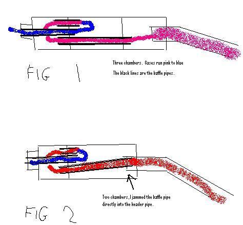

Here is what I did. Check out my awesome abilities in paint.
Basically I eliminated one chamber.
Oh yeah, i cut the pipe just in front of the footpeg bracket, and then skinned off what I needed, then jammed everything back together. Don't chop through the entire pipe, just the outer chrome piece. Once that is pulled away, you then trim back the inner cheese grater lookin muffler deally, so that it all fits together.

hmmm weird because I don't even have that long pipe chamber pipe... Where I've cut it theres about 10" of nothingness! All I was gonna do is cut 5" off and not touch any of the chambers as they are all up the other end.. ah well guess I'll just have to do it and see what it sounds like

Originally Posted by Sparks!
I don't get why you gotta touch the outlet side of the pipe?? and mess about bending the inner pipe??
I cut the header pipe end off my stock can today and will cut the main body about 5" off and then just weld it back together and move the bracket
seems no hassle at all but is that all I need to do?? seems like it to me??
seems no hassle at all but is that all I need to do?? seems like it to me??the point of cutting both ends is to keep most of the packing area in each chamber to keep it as quiet as possible.
like I said earlier... on my latest project pipe I left the rear end of the can untouched.
I cut both the lower can body (about 3in), AND the 2 1/2 inches of straight pipe going into the can itself to get the best length reduction and keep most of the chamber.
