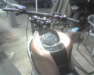

Originally Posted by kern0079
Not the greatest pic but thats how mine turned out using a rubber mallet. I have no paint chips at all but it isnt a deep dent.
hell yea...how did you get it to look so clean???
Here is another pic of it.
why didnt you make it just a little bit more dented at the top of the tank in front?? is it perfect right now for your *** to sit right in it??

Re: Lets See it....
Like I said before, go slow and work your way out from the center.

Re: Lets See it....
It is very comfortable. It could be pushed in a little more in the back but the filler neck is already pushed against the internals of the tank so I didnt go any farther.

Originally Posted by john LegionST
good lookin dent kern!!!
here, this thread may help, i dented the tank in post #14 (then nick TMF did a LITTLE bodywork...
https://www.stuntlife.com/forums/sho...ghlight=legion
also, here is an F4i tank i did
lookds good i like that lip in the back to hold your *** on the tank...

this is how I did it. you don't need to follow it but it might give you advice. We (me and 2 guys) stood on the tank (seperate times) and dropped onto my tank with our asses for like 20 minutes. Eventually it popped the crease just behind the gascap. That crease is gonna be a *****, but it's where the CENTER of the dent should be when you're done. All you have to do is slowly spread the dent evenly out until it's about the size of your ***. If you want, do it in steps and post the progress here and we'll try to give you advice on how to keep going w/ it.

NOT knockin the *** drop method, i have used that in the past, but the DEADBLOW hammer method and taking your time will produce more precise results! you can just be more accurate on where you want the dent to be ans where you want it to go.
I even use the dead blow to start the dent, usually at the rear side of the gas cap
