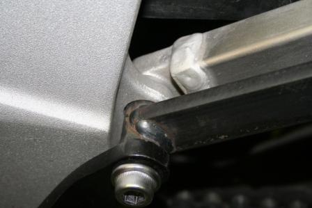

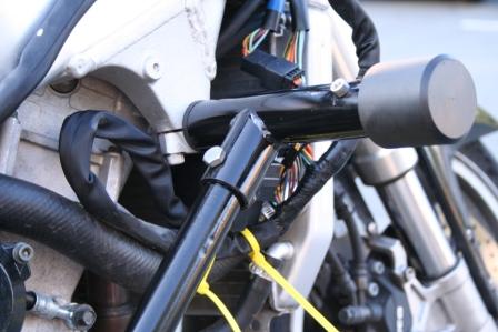

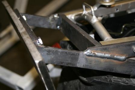

what du you think, will it hold up?

looks good. You got cross brassing and lower subframe bolt mount. That's the main thing. Those lower tabs break quick! The bar looks short, which is fine, but your angle seems wrong. Looks like it will hit the top of your bar and not the face. But I could be wrong.

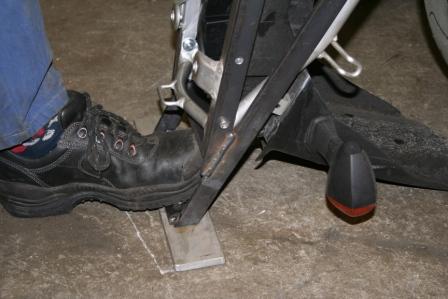

looks like this standing on it

It might change a little with your weight (suspension ) and if you deflate your tire it might change a little. But overall looks great! Have fun.

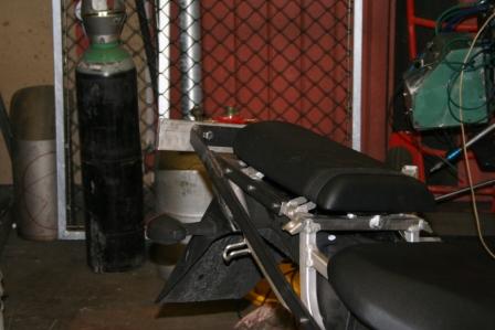

hers a picture of my cage to

looks like a tank

Better than the bottom of the bar digging into the pavement. Put the PSi air yo ustunt with in the rear tire and put a couple of nickels under the bottom of the bar when you weld up the plate. Accounts fo rsubframe flex when dragging.

Looks like that extended slider will be bending and breaking your motor mounts. Cut it shorter.

have thought about that. if you look closer you can see that i have a plastic bushing next to the frame. so if it bends the plastic will crack first. i also have cut the bolts on two places and welded them together. so if they stretch to much they will brake
