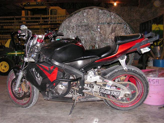

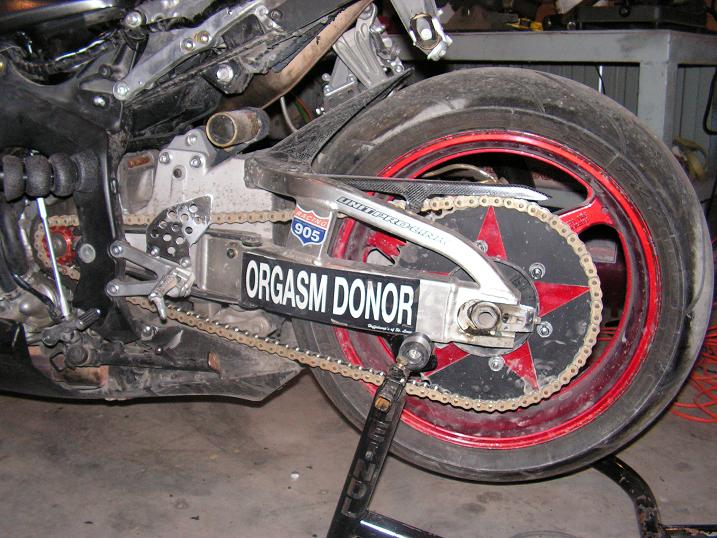

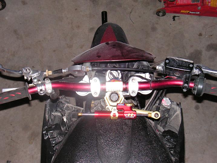

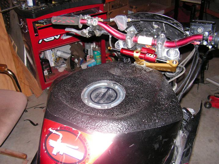

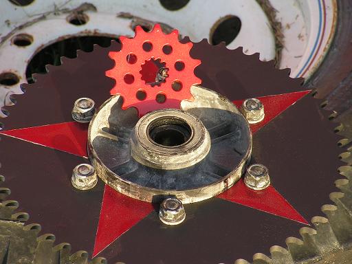

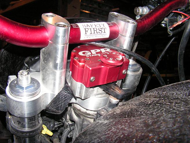

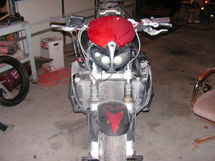

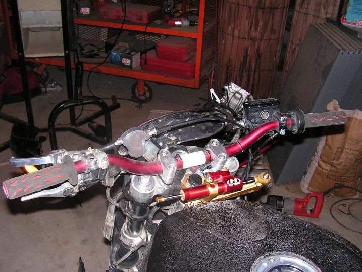

here's some pics I took today..........tank dent, with triple behind it with new ASV lever, 1000RR throttle tube, SF front end, hyperpro, front view.........blah blah blah......its cold, hop these work cause I don't wanna go out there again......burrrrrrrrrrrr
included a couple more pics.....plus one of jowalskimo for shyts and giggles

ahhhh i get it now. so you HAVE to have a piston type damper if you run your db bars like how you do. how come you went with the hyperpro now instead of your GPR? easier to get to?
Old Feb 17, 2006 | 01:02 AM
eazenutz33's Avatar
Posts: 3,733
From: .......
Re: 600rr Tank Denting
you can do it with the GPR.....BUT look at this pic and see how tall the risers are....crazy tall its so much better now, and the hyperpro is in a whole new class above the GPR(or at least the 6-clicker I had)

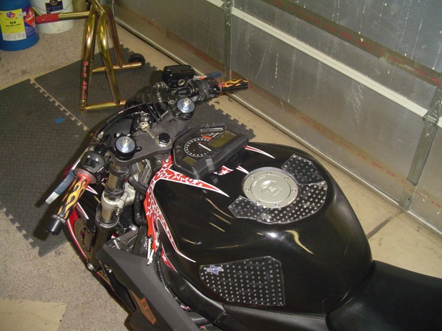

I am not sure if the pic is that good tell me what ya think, Maybe some advice on taking the pic!!! So you can get a better veiw?
oh ya ....I did it w/ a heat gun ....Smashed tank down first w/ rubber hammer put tank on heated it up to about 600 to 800 degrees and stood on it w/ some good thick lather "for the heat"....took about 1 1/2 hours good luck!

looks good bro:YEAH You like the plastic pointed stuff though??? Heard it feels like 500 things poking you in the *** at once.....didn't see anyu of it until after I had a guy rhino line the top of my tank. I tried grip tape, but after blowing the *** outta bout 10 pairs of jeans decided it wasn't for me
