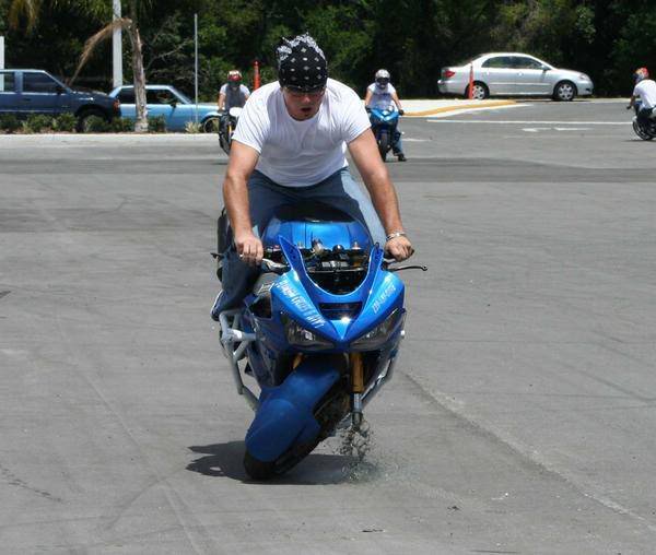

On the rear stiffer is better (in fact on the front too) people change the fork on B1h because of this

Seen that picture a few times, is it definatley real ?

yes it's real i know him
